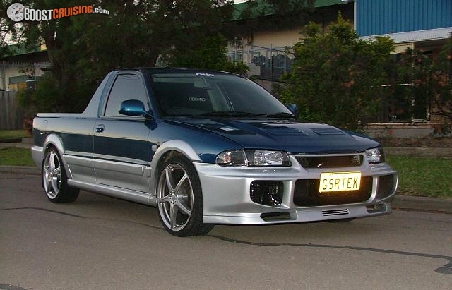

can anybody tell me if lancer bonnets and front bars fit on jumbucks?? i was told they do. if so what model lancer gear do i have to find?

it's cc lancer however there is a slight difference that make the front bars not directly interchangeable. in the protons the front fenders wrap around the indicator an meet the bar so the bar has a flat section at the join where as the lancers the bar curves up around the indicator. it's not much of a difference but it does make it a little harder. as far as hoods go straight swap cc coupe(important as sedan are different again)
the one you have pictured has a sedan front end conversion done in stock form the jumbuck has a similar front to the cc coupe. in order to fit a sedan front end you'll need to modify the front guards. by cutting up sedan guards and mating them to your proton ones. atleast as far as i know thats how it's done.
theres a couple of jumolutions jumbuck/evo and they're weapons in turbo awd form
Riverside
If you want sedan front as pictured. You need to change everything on the front end. Check out my for sale topics. I did it to mine. You should buy it smile.gif
