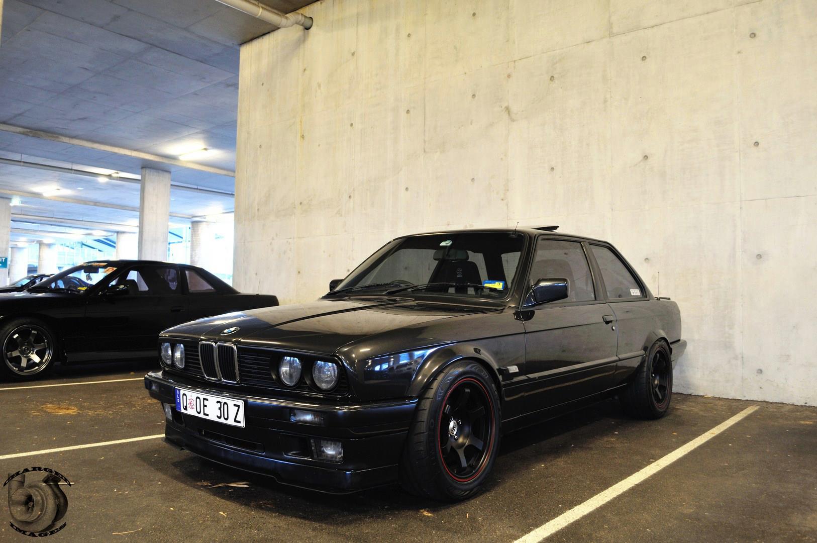

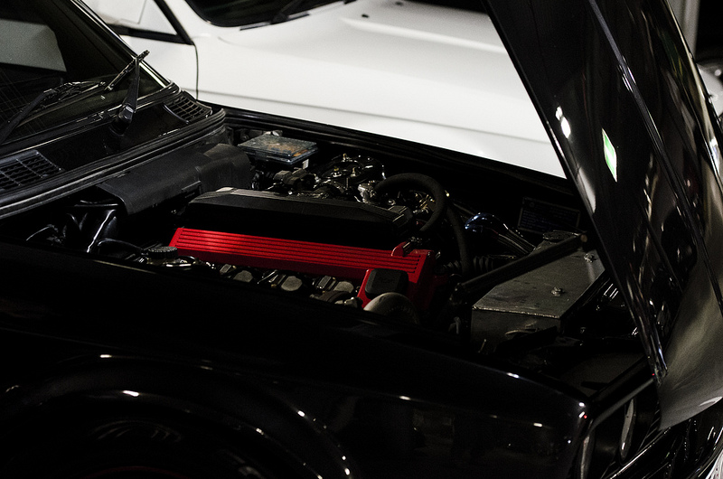

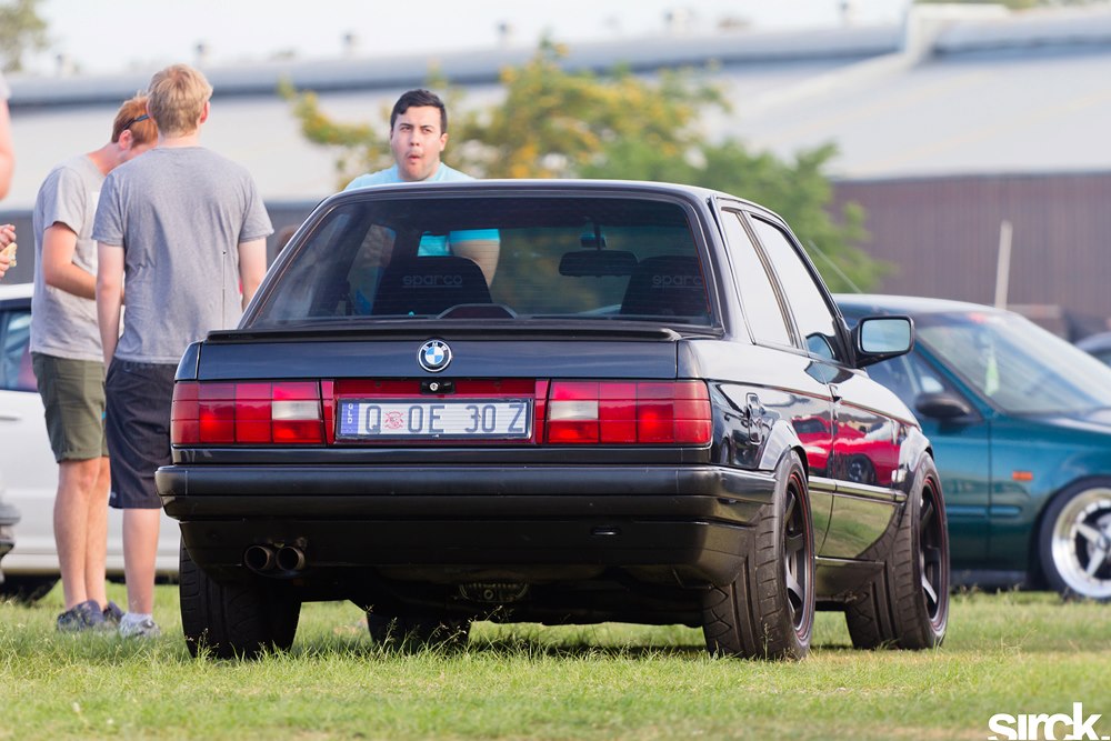

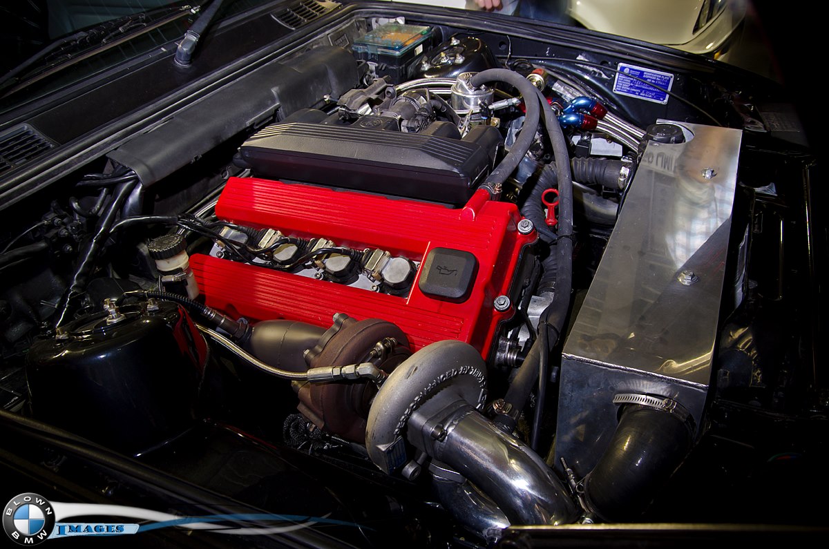

Figured why the hell not, Bought the car 6 years ago and drove it around mostly stock for that time. About 2 years ago I started the turbo build, I did all the work myself so it took some time but I'm incredibly happy with the end result and it turned out how I wanted it to. Once it was finally all finished I got a run in tune done and it made 218whp on 8psi, Going back in Feburary for a tune for 15psi hopefully smile.gif.
Stock BMW Forged Crank
Stock BMW Forged Rods
8:5:1 CP Forged Pistons
ARP Head Studs
ARP Main Studs
ARP Rod studs
MLS Head Gasket
New timing chain, guides, sprockets and tensioner
New BMW Valves, guides, springs & retainers
Custom clutch off M20 fitting with 6 puck button clutch
Custom made turbo manifold with external gate
Trust T517z with 8Cm rear housing
Custom 3 Inch dump pipe to twin 2.5 inch exhaust all the way through
Ground control Koni/Eibach Coilovers
All new urethane suspension bushes from Ireland Engineering
UUC 4 Piston 300mm Big brake kit currently in the post on the way
Haltech PS1000 with Electronic boost control
